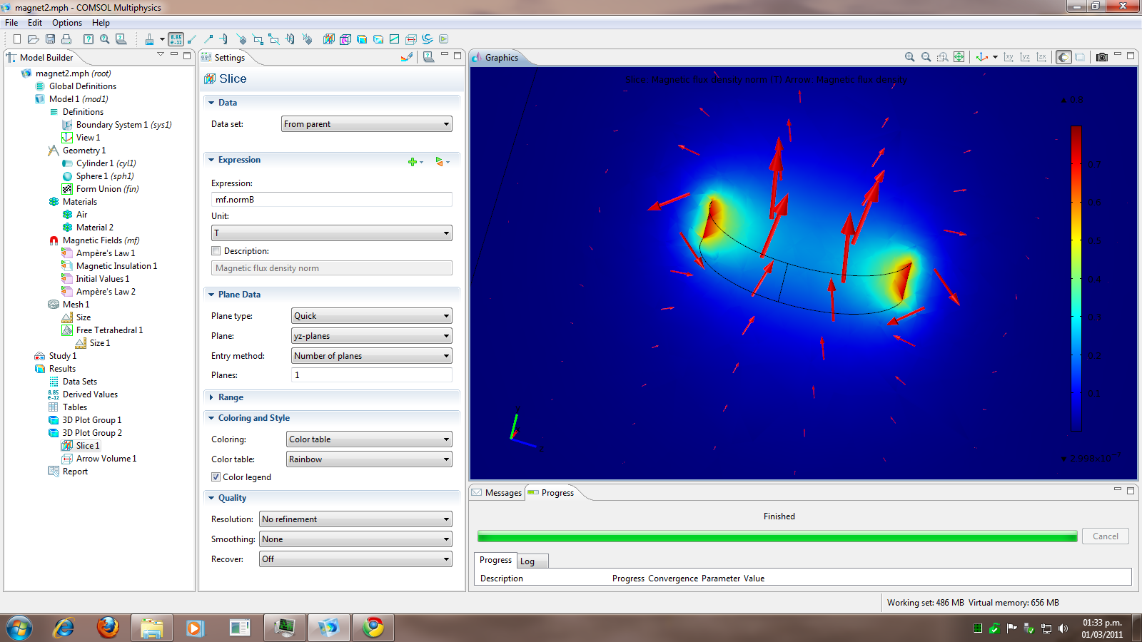

This is what I'm looking at. I followed your instructions and created an "Extremely fine" tetrahedral mesh for the magnet and left Mesh1-->Size at "Fine."

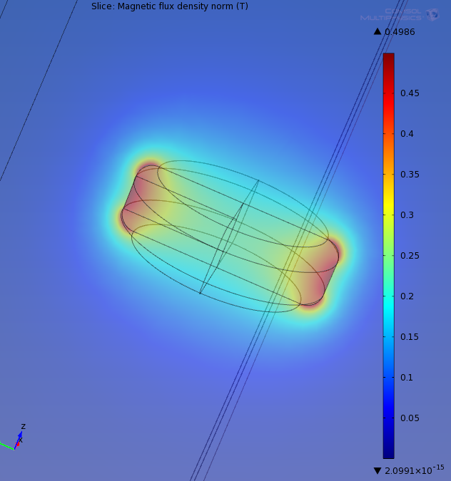

I'm afraid regarding the singularity problem, I have the similar question. Is it simply because of the corners that caused such nonuniform distribution of the field strength in the magnet? I attached a similar picture of the cylindrical magnet resulted from my simulation. Thank you very much!
Attachments:   Capture.PNG

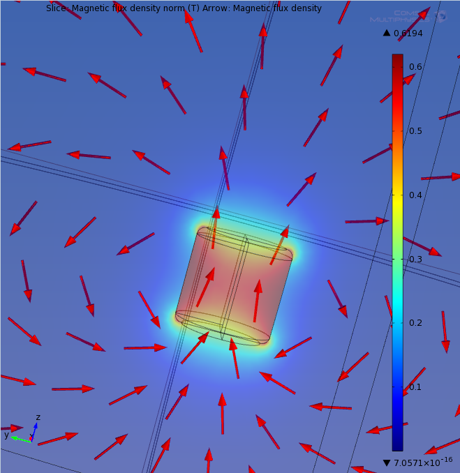

Hi, Ivar,
I tried your method based on your model but still get more red on the edge. I don't understand and am totally confused. I'd really appreciate if you could give me some help on this. Thank you so much!
Best,
Chang
Attachments:   Capture2.PNG

However, when the geometry's aspect radio gets close to unity or greater, it becomes more uniform. Now I'm confused if it's physics or it's artifacts due to the simulation boundary setting, etc.
Attachments:   Capture3.PNG

I have been out of houise for some time ;) for me the field concentration ou nthe outer part of the coil is normal, in the sens that depending on the physics and BC you use you will have (or not at all) the effect on the current density by the field itself, that will push the current to the edges (skin effect). this is also very frequency dependent. Mostly with simple analytical means one forget these "2nd order" effect, even if they are often far from negligible.
But they can only easily be shown with tolls like COMSOL (and there are not many).
So sharp edges = singularities = partially wrong results for numerical reasons,
but current densities tending to increase at the outer border = physics applied correctly, and is a "feature" of a bulk coil
That is also why one tend to use multiple turn small wire diameter, or even coils made of thin films and not wires. Just as for higher frequencies, the current rtend to circulate at the border of the conductor and NOT in the middle, as the electroncs are repelled from centre by the generated magnetic field
